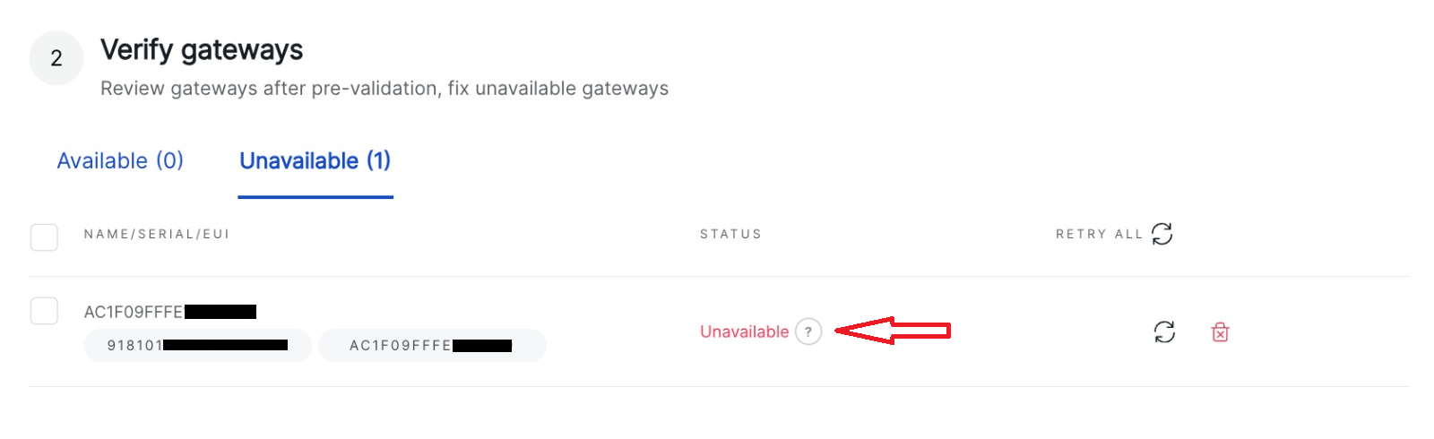

When assigning a gateway to a Location in WisDM, the system may return specific error messages or statuses. These messages indicate why the assignment failed or requires attention.
This article explains the most common statuses and how to resolve them.
Click the question mark (?) icon to view more details about the error or status.

Unavailable
Description:
The system cannot retrieve the gateway’s data.
Typical Cause:
  • Gateway not yet connected to WisDM
  • Cloud-side delay or sync issue
Recommended Action:
  • Ensure the gateway is powered and online
  • Wait and retry the assignment
  • Contact RAK WisDM Support via the built-in support form in WisDM
