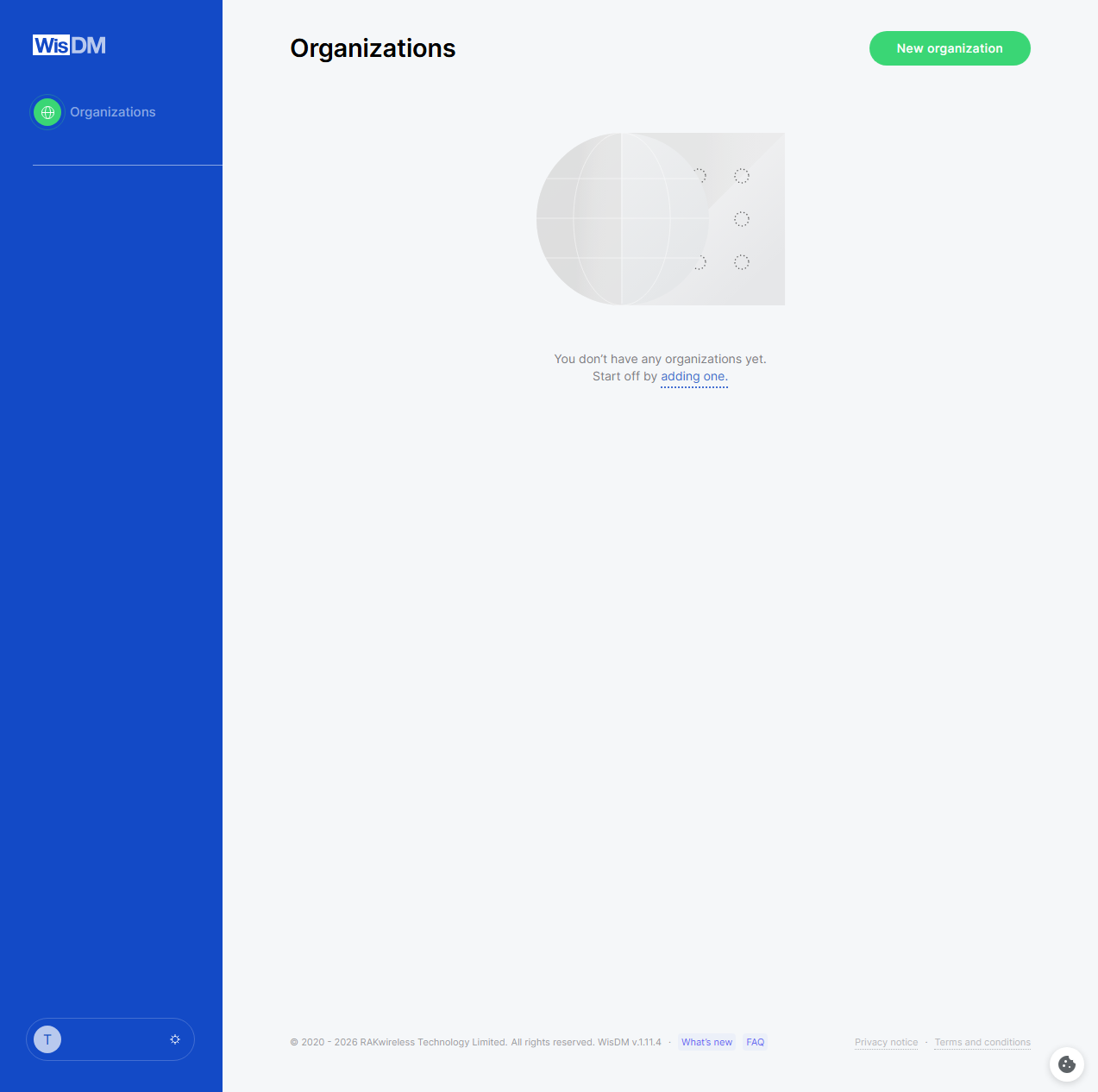

1. Sign In to WisDM
Open the WisDM platform and select Sign in with RAK ID.
Sign in using your existing RAK ID credentials. If you do not have a RAK ID, create one and complete the email verification and Terms and Conditions acceptance process.
After signing in, you will be directed to the Organizations page.
WisDM Login and Organization

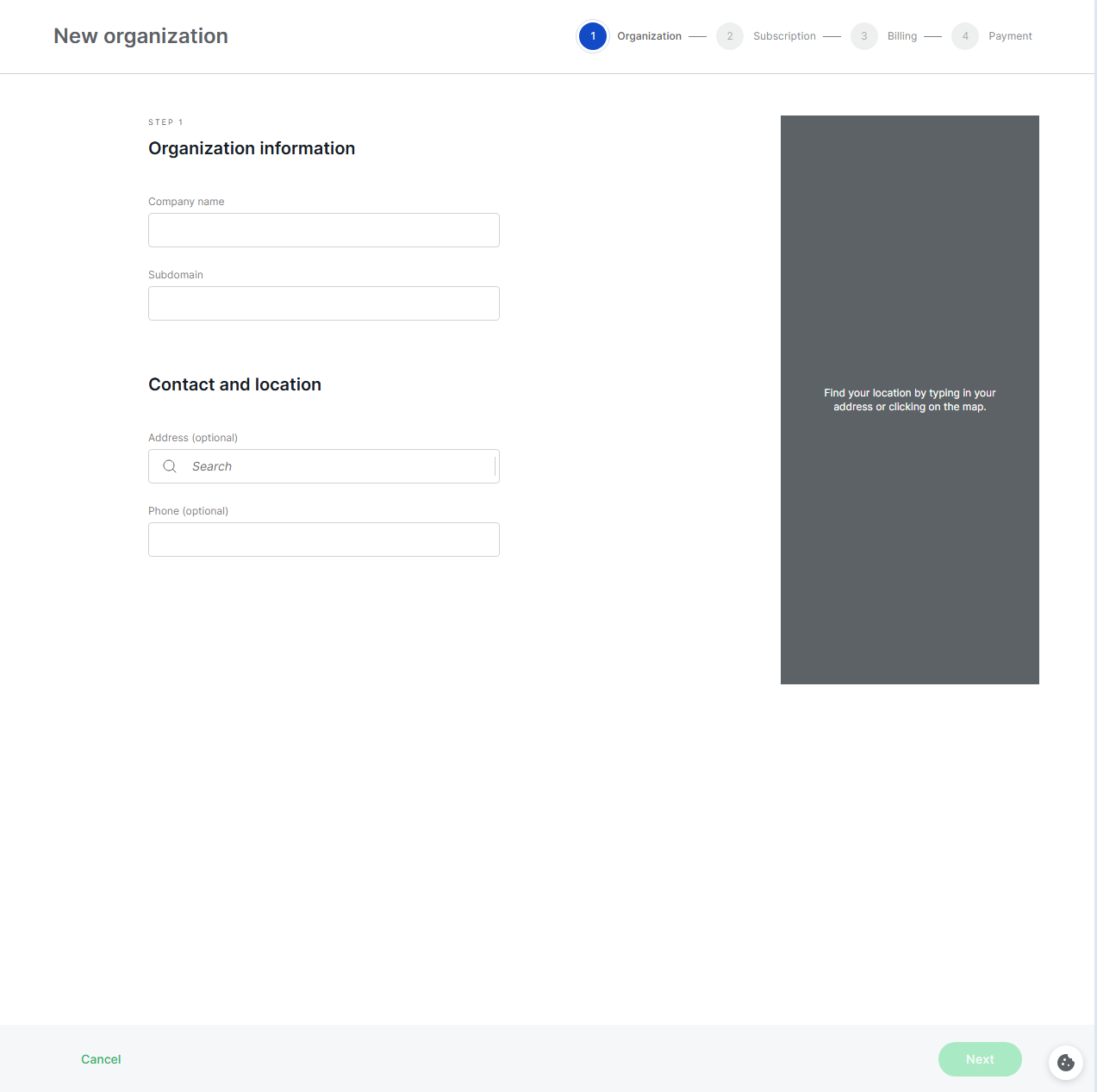

2. Create an Organization
An Organization is the top-level workspace in WisDM. It contains your Locations, gateways, users, subscriptions, and organization-level settings.
  1. Click New organization.
  2. Enter the required organization information.
  3. Select the appropriate subscription plan.
  4. Complete the Organization creation process.
For testing, proof-of-concept, or small deployments, the Community plan supports up to three gateways.

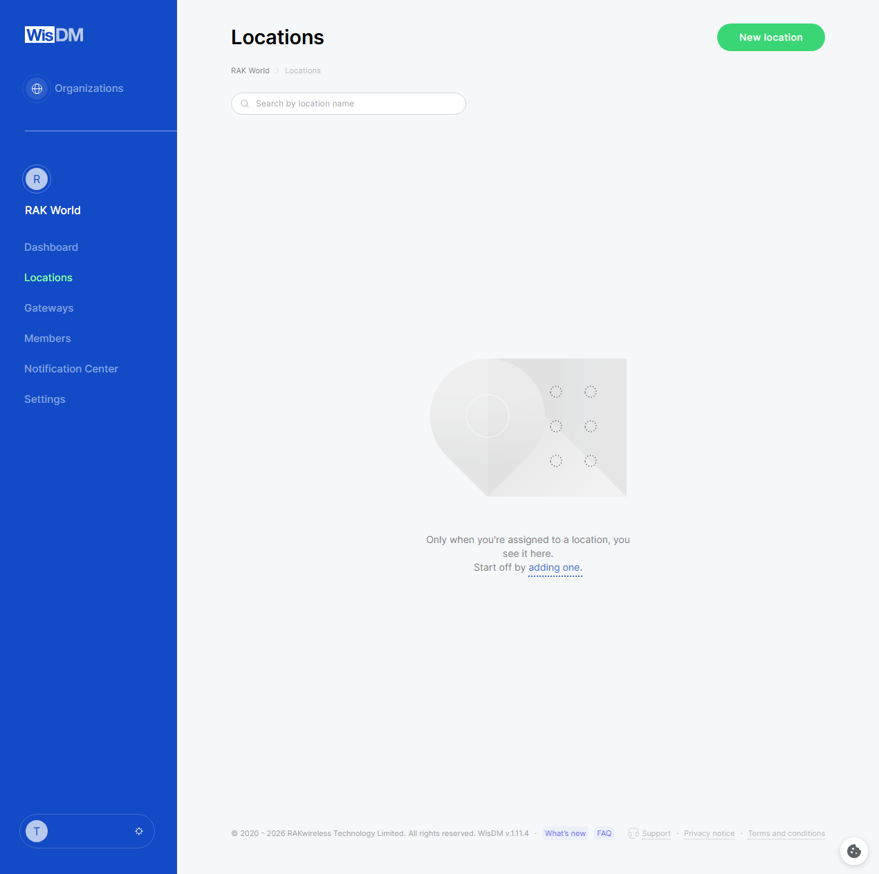

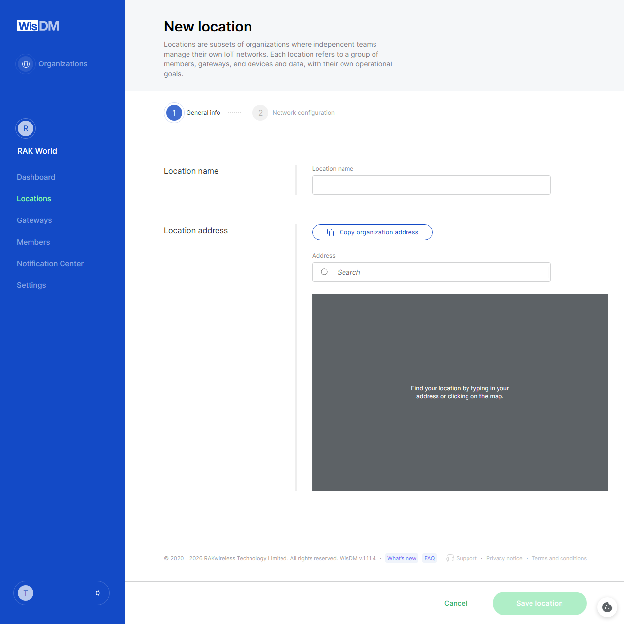

3. Create a Location
A Location groups gateways that share the same LoRaWAN network configuration.
To create one:
  1. Go to Locations.
  2. Click New location.
  3. Enter a Location name.
  4. Configure the Location address if required.
  5. Continue to the LoRaWAN network configuration.
Add Location
Add Location Details

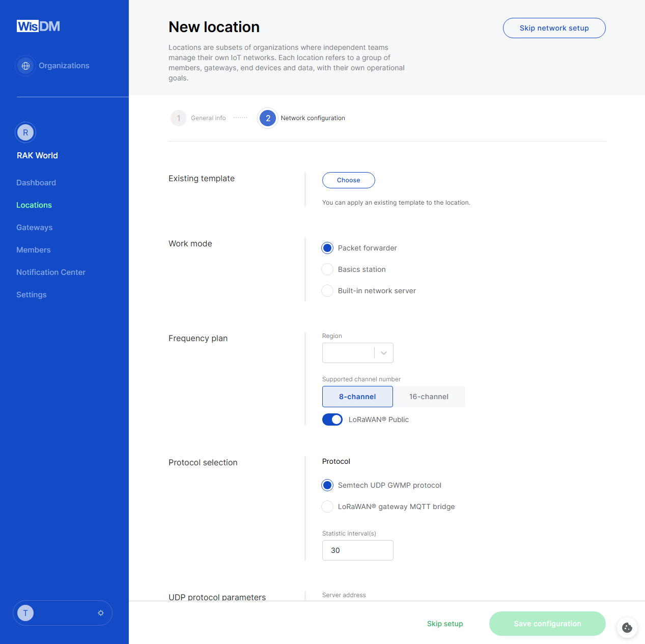

4. Select the LoRaWAN Network Mode
Choose the work mode according to how the gateways will connect to the LoRaWAN Network Server.
Packet Forwarder
Use Packet Forwarder when connecting to an external LoRaWAN Network Server using Semtech UDP Packet Forwarder or LoRa Gateway MQTT Bridge.
Basics Station
Use Basics Station when connecting to an external LoRaWAN Network Server using the LoRa Basics Station protocol, including CUPS/LNS and certificate- or token-based authentication.
Built-in Network Server
Use Built-in Network Server when the LoRaWAN Network Server will run locally on a gateway.
One gateway acts as the Central Gateway, while additional gateways can operate as Extender Gateways.
Configure the required frequency plan and network parameters, then save the Location.
Configure the Location Work Mode

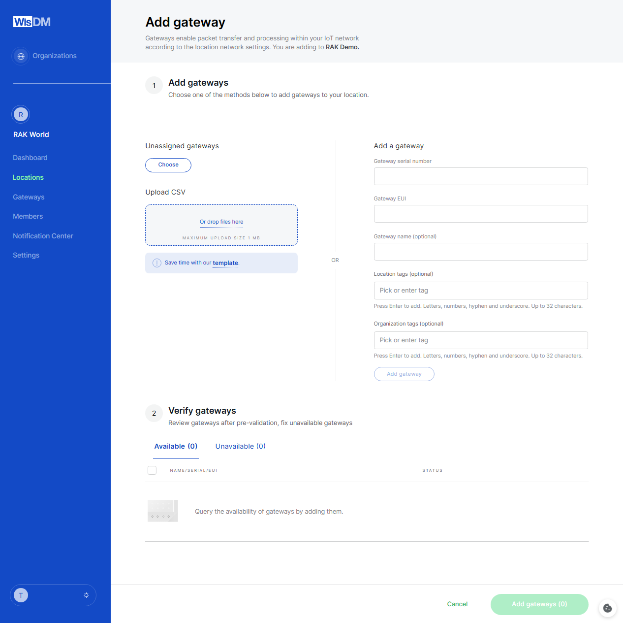

5. Add Your Gateway
Go to:
Locations > Select your Location > Gateways > Add Gateway
Enter:
  • Serial Number
  • Gateway EUI
  • Gateway Name – optional
Click Add.
WisDM validates the gateway against the selected Location.
The gateway will appear as either:
  • Available – the gateway passed validation and can be added.
  • Unavailable – one or more validation checks failed. Check the Status column for the reason.
If the gateway is Available, select it and click Add gateways.
Note: In Built-in Network Server mode, the first gateway becomes the Central Gateway and must be online before it can be added successfully.
Adding gateway/gateways
