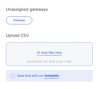

  1. Go to Locations.
  2. Select the target Location.
  3. Open the Gateways tab.
  4. Click Add Gateway.
  5. Find the Upload CSV section.
  6. Click the template to download the provided CSV template.
Download the CSV template

Upload the CSV
After completing the template:
  1. Return to the Upload CSV section.
  2. Drag and drop the CSV file into the upload area, or select the file manually.
